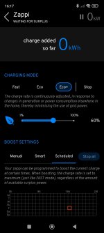

That's a screenshot from my Zappi having plugged in about an hour ago. All schedules have been removed in the car and in 3 months I've only had one failed charge. Plug in having set the % to add and the time it needs to be done and it's normally set within about 30 seconds.

I have the same setup and my zappi is the similar. I have it set to manual and the slider up to 100% in eco+ mode.
