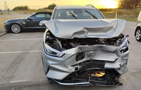

They were asking a LOT more than £350 to fix my chargeport back in 2022. :)
Yes, it doesn't take much to write a car off these days.
My father was a panel beater and as a kid, all our cars were write off's that he bought from the insurance companies and fixed up.
