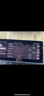

Since having the car I’ve put it in Sport mode once, have you tried changing the settings as seen in picture below to see if there’s any improvement? Pedal Force, BHP etc?
Mine is the Long Range Trophy
