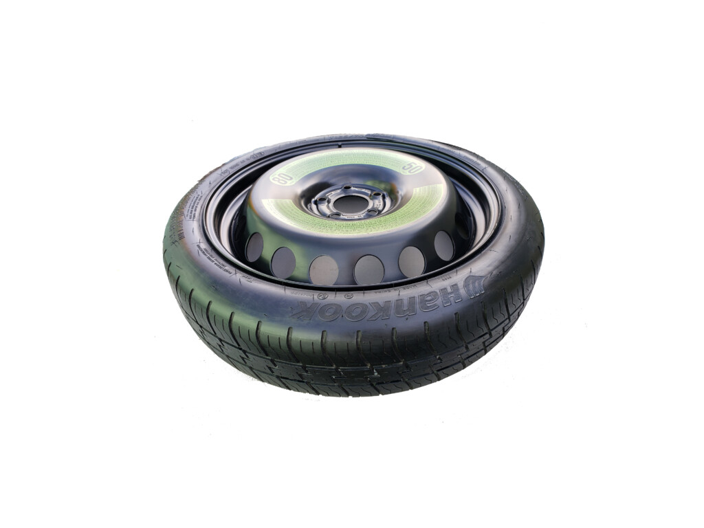

I know there are a lot of threads on this, but none seem to cover my specific question.
(Or at least, I'm not practiced enough to find it...)
Looking for a space saver spare for a 2025 ZS SE EV.
The car came with 215/55/17 tyres.
All over the internet there seems to be conflicting info. But most seem to suggest that a 16" spare is fine and can be used in place of all 16/17/18" rims. And the most common tyre fitment seems to be 125/70/16.
So that's what I ended up with. But it seems awful small! 15% too small.
Surely this can't be right.
And even if it were a 125/90/16 it would still be almost 6% out.
What do MG supply ??
Hi
I purchased my space saver spare wheel kit through this forum, from someone who got it from their MG main dealer but subsequently sold the car. It was a facelift ZS EV Trophy, like mine. It is 125/90/16 which matched many being sold online. I've never had to use it and hopefully never will but it's reassuring to have it in the boot!
I found a 125/90/16 which was a much better match.
I can't remember where I brought it from, but will post here if I find an invoice.
