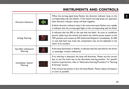

@goose I came across this in the manual for the ZS about a warning of low battery in the key fob. Not sure if the MG4 has the same?
Key fob low battery warning is displayed on the screen.
From the MG4 owners manual:
