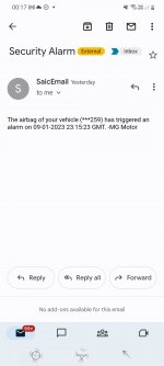

Had this email 30 mins ago. Gone out to check the car....the key fob does nothing when pressed, but all the doors are open. Everything dead inside...car won't start or respond to anything.
Charger is plugged in....but won't unplug. No lights at all on charger port.
Gutted
Anyone any ideas?
Update. Ive seen another thread here with someone who had a very similar issue.
Now reported to MG Assist who will be here first thing in the morning. Ill be phoning the dealer, but have also emailed them ahead.
Very concerned that the airbag has either tried, or could try to deploy.... just glad this happened whilst it was on the drive in an evening and not whilst we were driving it.

Update. The AA have just been, and he tested the 12v battery, it was completly dead. Kudos to the people who said that could be the problem.
The AA guy charged the battery enough to get the car functioning.
Now obviously something has gone wrong for the battery to go to zero in a couple of hours between me last driving it.
When he got some charge in and we switched the car on, the dash was full of warnings....airbag....traction control....sensors...lane assist etc.
As he charged the 12v the warnings all went away. So Im now assuming the airbag warning is just part of all the other warnings....it just so happens that the airbag warning triggers an email.
So the problem is....why did the battery end up at 0%. Ill be driving it to the dealer shortly, to leave it with them to investigate.

The Christmas tree affect of warning lights on the dash, is triggered when the 12 volt battery state / voltage drops to low.
Charging the battery will usually clear the faults automatically.
When your car is in READY mode, with a healthy battery you should be seeing around 13 - 14 volts SOC on your battery.
Is there any chance you left something still turned on in the car, or left one of the doors or the boot slightly open ( leaving the interior light on ).
The dealer will no doubt charge the 12 volt battery to full and they check its condition, while scanning the car for any fault codes.
The battery could just be a faulty unit ?.
Good luck and report back !.

As above.... the faults regards the air bag were a complete red herring. the real issue here is that the 12v battery was at close to 0% and thus nothing could function.
The dealer now has the car, and a full explanation of what happened. An initial theory there end is a door locking fault that perhaps meant the car was still powering the interiors.
they are going to be getting the battery sorted, and then running some tests to see how efficiently it behaves.
I cant fault the support MG gave me today....hopefully its swiftly diagnosed and resolved.
