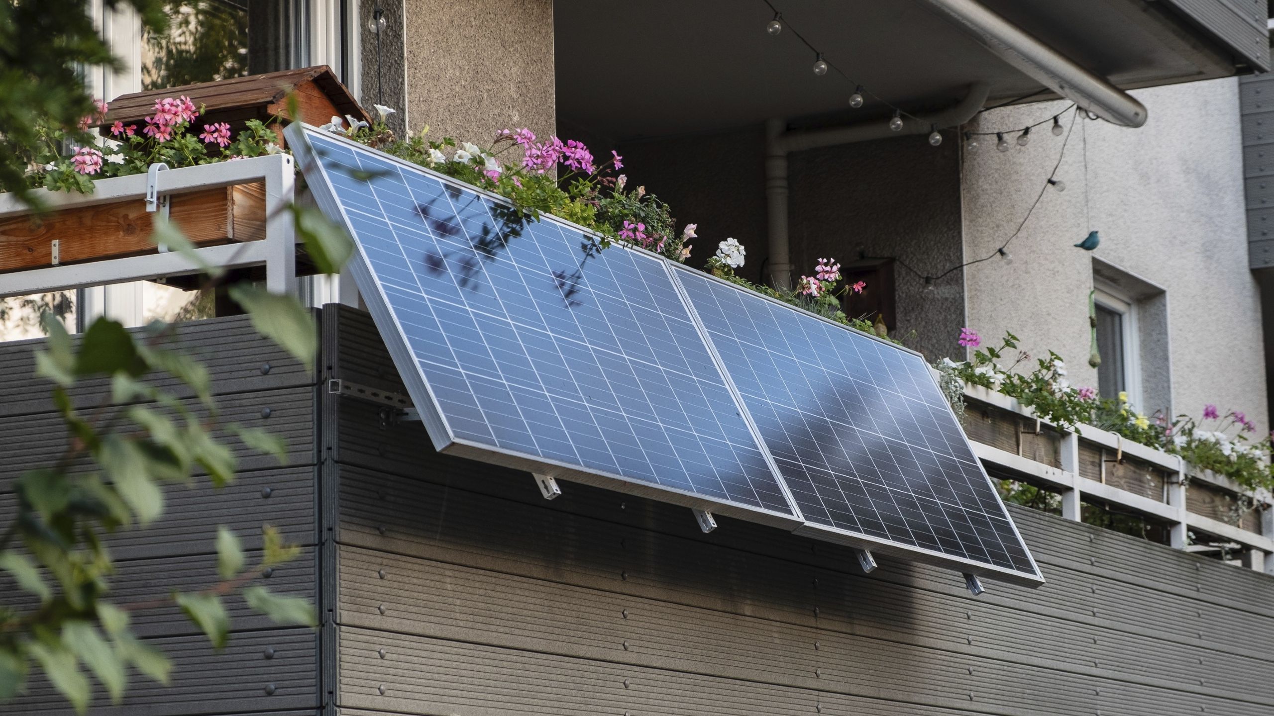

From what I understand there are two broad concerns, but perhaps there are others I have missed...
There is a the potential backfeed issue (devices don't shut down when the grid goes down like they are supposed to). Hopefully the technology will stop this, if all the devices are of suitable quality and they don't get fooled into assuming that the grid remains when it is not. This is a risk to line workers.
Then there are the concerns about the internal wiring in people's homes not being capable of handling the extra load and overheating, which is a risk to those in the home.
Anything I've missed?
