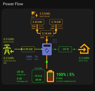

My solar and battery are all installed and running. After a bit of a saga because of a very minor but crucial oversight by the installers that has taken almost a week to rectify, I have 7.36kWh array , 3.68 each on my ESE and WNW facing roofs.
Also because of this oversight I have a 10kW inverter and not the 5 I was quoted for. I'm just waiting for my export to be activated by Octopus.
I've set up modbus and home assistant to monitor.
Fantastic!
Nice.
Wow - did the DNO approve that? Or are they going to have to de-rate it to 5kw?
Does it offer 10kW discharge from the battery? That would be very hand for backup purposes! :D
Even if it is 10kW only during sunny times that would be great.
This can take a long time. In the meantime you can try to use as much yourself. Easier to do if you have an EV!

One of the outstanding issues for me is that the DNO have been advised that a 5kW inverter version has been installed. As far as I know , the DNO records have not been amended. It was limited by the installer to 5kW.
I believe that it allows for a DoD of 5%. so its around 9.5kWh actual usable capacity.
