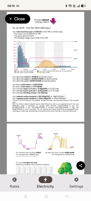

Can I ask what your yearly usage is like for electricity with and without your car?
I use Octopus Watch for creating reports:
