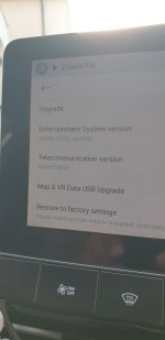

I have R33 in the UK. Collected car 1wk ago. Also have same issue with having to keep pairing and multiple versions of MG appear in my phones Bluetooth list. Could it be the Telecommunications E32 version?
I have the exact same version (see previous page) and it works absolutely flawless since the update.
