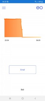

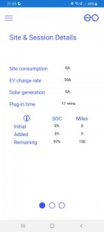

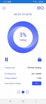

Just reading this, on the app for EO Mini Pro I get currently using. And after a graph once finished.
