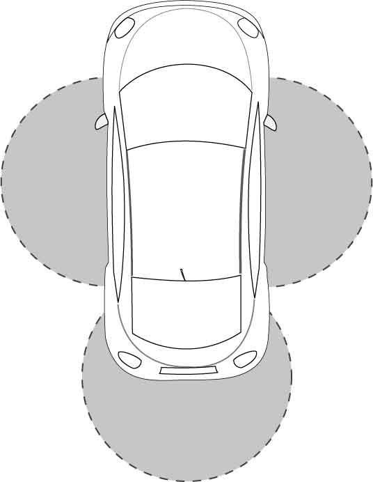

Fortunately I have a Faraday pouch in the car and asked the AA to put the key in that before hiding it under the wheel arch. Without a Faraday pouch and with keyless entry any opportunist could simply try a door handle and get into the car and steal things such as charging cable, V2L adapter, 12 volt booster etc.
I wonder if that's true. The extent of the area where the car detects the key seems to be very limited. A couple of times I have put my handbag down, with the key in it, very close to the car, but it still wouldn't let me in until I picked up the handbag. It's possible the wheel arch isn't covered.
It's easy enough to check. I might do it this afternoon.
On one occasion when the car wouldn't open my handbag was on top of a stack of boxes in the garage, about waist height, and I would have thought within the zone marked - only about a metre from the side of the car. But nope.
On another occasion I was standing beside the off-side rear door with stuff in my hands, and asked my passenger to press the passenger side door button to unlock the car for us both. Nope. I had to move forward and press the driver's door button myself. This may have been because the door button being pressed was on the opposite side of the car from the detected key, of course.
OK, I checked. @wandle MG4 trophy was right to be concerned. I used a blob of Blu-tak, and no matter where in the wheel arches I placed the key, the doors opened. Even when I put it right at the front of the front arch, where I thought that arc might not quite reach.
There's also the point that if the doors open easily, a thief might put two and two together and start looking for the key in the wheel arch. Or just chancing his luck and seeing if he can drive the car off.
I have also ascertained however that if the key is on the right of the car the left door knob will not open, and vice versa.
