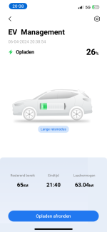

Yesterday i was pretty happy with the charging speed on my standard range ?
Soc was 18% when i start charging .

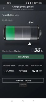

See attached. 87Kw speed achieved. Anecdotally, I have seen the below (from the old version of ISmart app screenshot) on a few occasions and would consider reasonably normal. Obviously making allowances for charger/temp etc. But would say this wasn't exceptional.
