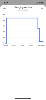

Don’t know, I’d have thought that 70% = all cells at 70% charge rather than 70% at full charge. I can confirm my charge to 70 today did a balance at the end, it looks like it anyway from the graph. There must be a reason MG suggest 100 now and again though.

Apparently the balance works to equalise all cells to the same level so should balance all the cells at whatever SOC that you have set . So it should be balanced but you don't need to charge to 100% , otherwise there would be no point in it taking over an hour at something like 0.1 kw once it has reached the SOC set limit.
