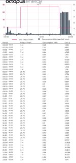

The best bit about intelligent is that when you plug the car in, octopus will start charging your car at cheap rate, if they have spare electricity… here’s a good example, plugged it in around 8pm and the car started to charge… see bill below
Last Monday I plugged it in at midday and car started to charge, so I knew everything was going to be at 7.5p, so j mowed the lawn and did some hedge trimming all on cheap rate… I love octopus energy

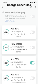

I have
Car set to stop at 80% normally or to 100% once a month or when doing a big trip (LR battery)
No other settings in the car

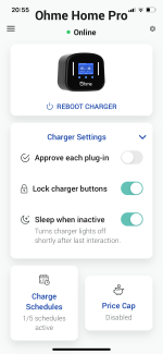

Ohme has no price cap set, and this is probably overkill but I have multiple schedules set 10% 20% 30% -> 90% charge to add before 7am
I select the "one above what I need to get to 80%" then plug the car in.
This gives the freedom of the IO plan to work with the cheap power times, without taking the piss... asking it to do 100% charge when you only need 40% is counter productive for what the scheme is trying to promote, as it will overcompensate and try to squeeze earlier charges in, when overnight will be more than enough.
It did once decide to charge from 4pm->10pm on a Friday earlier this month, but both Ohme and Octopus said if it was set to intelligent charge, and that is what happened, then let it... it was both sunny and windy, so could be correct.
I await this month's bill :)
I am not sure if setting "do not charge over 7.5p" would have stopped this from being possible, due to the 7.5p being 2330 onwards according to the tariff rates, so that is why the setting is disabled.

Pretty sure it will stop the "extra" charging - Octopus say you should not enable that option.

Please do not set to 100% - it defeats the purpose of IO and what Octopus are trying to achieve. They will try and schedule far more charging than you need.
Personally, I just leave a "add 30% by 9:30" profile set, then when I plug the car in you can override the current session and just adjust the silder to 5% more than I need to get to 80% or 100% - very occasionally I adjust the time (I'm retired!)
