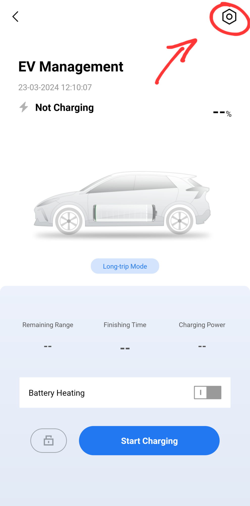

New Trophy LR owner here. Delivered on Thursday. Only now finding out about the scheduled charging issues. Previously had a an eNiro, which never missed a beat! I'm now 2 for 2 for not charging on my cheap overnight tariff. It does charge manually, and sometimes it will charge when i play around with scheduling during the day, but nothing at night? I've reset my Matt:e box (several times), I've payed with the app, and also tried with no app and just the car system. Ill keep trying, but not being able to plug it in and have it ready for the next day just isn't a reasonable issue to live with. Now regretting my choice. and might have look at another another eNiro. Pity really as I do like the car.
Any help would be great to save the car from a return!
EDIT- 27/03. After some frenetic testing, I've now resolved the issue, and is charging overnight. Happy bunny and the car is staying.

Correction: my car wasn't broken, it was a misconfiguration issue - somehow a car schedule got set that didn't allow charging except during specific restricted hours. Once that was cleared, everything works again.
That's good news.
