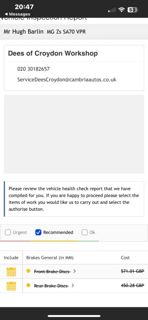

It appears that all the evidence points to them " trying it on " if they were serious they would have put it in writing? which would put themselves in a better position legally.
In fact they included this in their report. (I’ve shown only the references to the brakes). It’s a bit puzzling because it’s the second they sent. The first does not have the strike throughs. What’s shocking is that you can buy a pair for under £100.
