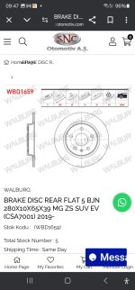

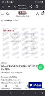

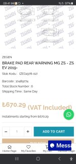

Lots of after market parts now available in Turkey for MG zs ev. Pick up rear brake pads for £17.00 (exchange rate 44Tl to pound) rear disks £37.00 pair
Thanks, good to know. But, would not using original MG parts invalidate warranty? I guess not because break pads and discs are not covered by 7 years warranty ... ?

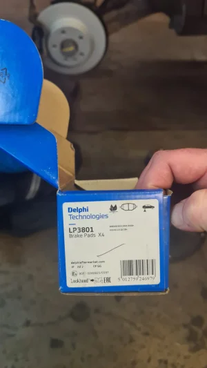

They look identical to the 2020 zs ev pads, thanks for this information maybe order a set to try.
Fitted yesterday, all good

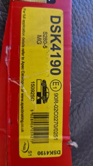

That's a really cheap price, I recently bought discs for £56.00 but had to fit myself
