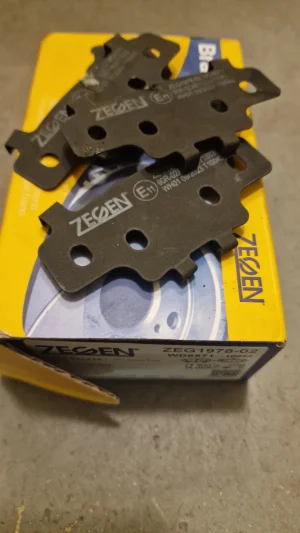

First I released the parking brake then disconnected the 12V negative battery terminal, I then used a 12v battery and reversed the polarity at the motor connector to move it in and out. It also required to be pushed in, removing the connectors from the motors was awkward. When I connected the 12V battery a few faults appeared along with a flashing N in the drive selector, a short drive and all cleared so no problems.

Starting up when the job was finished the brake pedel was very firm and needed no pumping. The anti squeal backing had to be removed from the pads to get them to fit
