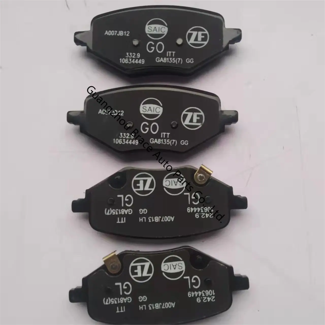

Hello
My daughter has gen 1 2020 and the only listed rear pads are not the type fitted to her car. The ref number on the pads is SIAC TRW GA8135, any idea where these and disks could be obtained, apart from MG
Hello
As far as I am aware, there is no third party suppliers selling discs and pads for the ZS EV model.
The MG HS PHEV - Borg & Beck are able to provide the fronts for them.
I wonder if they are able to procure them for the rears ????.
The MG HS PHEV - Borg & Beck are able to provide them.
I wonder if they are able to procure them ????.
Thank you
Hello
They look identical to the 2020 zs ev pads, thanks for this information maybe order a set to try.
They do look very similar I have to admit !.
It's a shame that some of the part numbers on the old pads are obscured.
Before you order them, ring your local MG parts department and ask them if the part numbers for the rear pads for the HS is the same as the ZS EV ?.
If they confirm, you are 100% sure of the fitment !.
We know for sure that Borg & Beck make the front pads and disc's for the HS.
If they can supply the rears for the HS and the part number match, then that maybe a quicker fix IF you are in a hurry ???.
At £16.66 they are going to be hard to beat on price thats for sure !.
Please let me know how you get with you conversation with the parts department (y).
