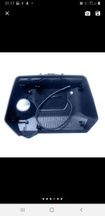

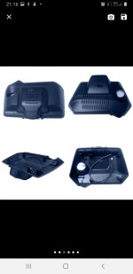

Have not taken it off my self, but remembered your question when I saw this on AliExpress. Not quite sure this is what you are looking for, but this looks like it just snaps on an should be fastened like the original plastic trim.
I have made contact to some sellers already, they are left drive version only.
Can you please post the link as to where you purchased them from ive searched everywhere
I have had this one sat in my cart on AliExpress for ages, debating whether to get it. You will need the 12v to 5v buck converter too and then wire that converter to usb either with an adapter cable or make your own. Not the simplest but if you know a little about electronics it shouldn't be hard. Stecker und spielen Power Kabel Für Auto Dvr Dash Cam Für BMW Für Audi Für VW Für Mercedes Benz Verbinden die Regen Sensor/Lesen Lampe - AliExpress 34
