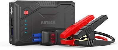

Worth getting a booster pack to keep in car. The size of a mobile phone so can sit in glove box or in rear nets.
Just bought a NoCo GB70 Lithium ion for a booster - 2000A and the size of a housebrick, but I bought it because I have one of their maintenance chargers which kept my old ICE Toyota battery just perfect - just left it plugged in until I needed it. I love my #TeamRed ZS Exclusive but I do miss my old racing green (22 year old!) RAV 4 - never gave me any probs and was my first car...
