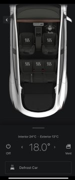

Not sure if this has any relevance but my Tesla regularly sees 40c+ when parked on a hot day. For example now it’s 13c outside and 23c inside while parked up.

I Agree. The only thing that is relevant is that you can set a max temp for inside (say 40c) and if it’s reached it auto turns on hvac to cool the interior.
