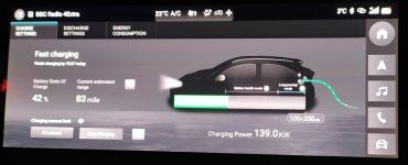

I have never used battery heating on my Trophy. We just drove down from Scotland (350 miles) in similar temperatures and the car pulled 130kW+ from the charger mid journey at around 30% SOC. I can't see how it would have been much if any more had I used IBH as that's nearing the best it will do!
This picture was taken a while ago on a Tesla charger. As you can see, the temp is 3°C and it's charging fine without using battery heating.

it’s the battery temperature that counts: if your battery was already warmed up through driving it then it won’t matter much.
Again it’s about SoC too: when charging from 30% the BMS knows the battery doesn’t have to be super warm to start pulling higher current rates. But if you was to charge from 60 or 70% it would be a different story.
That's why I've never bothered with battery heating on a journey. I will only need to charge after I've driven a good distance.
Of course, which is why I stated SOC! :)
