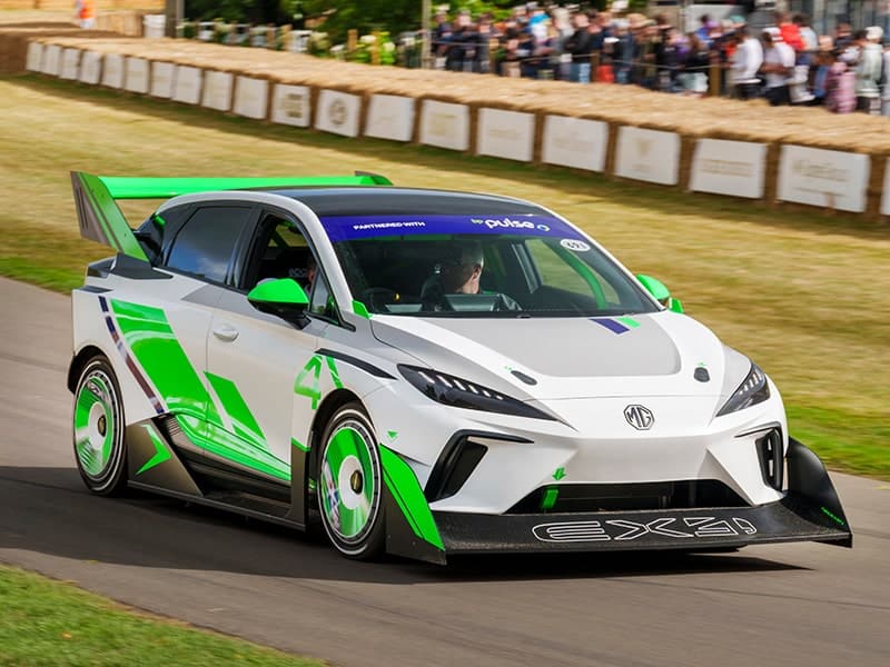

If MG had any sense, the "EX4" special they took to Goodwood would've been unrestricted.
