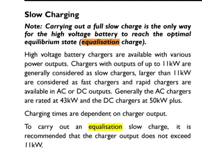

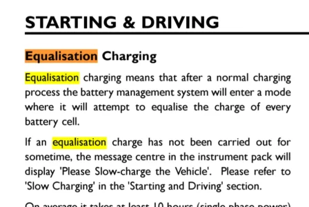

@MarkHoward, you have introduced the adjective 'full' in front of 'equalisation' and this can lead to some saying that a 'full equalisation' can only be done at 100% battery level.
The MG4 manual shows the information, from different parts, as below.
From the first extract it could seem that an equalisation charge means charging to 100%. However the emphasis of the extract, to me, is the achievement of the 'optimal equilibrium state' through slow charging with an equalisation phase.
The second abstract provides a definition of equalisation charging, that it is charging continuing after a 'normal' charging process has completed. It does not define a 'normal charging process'. For MG4s with an LFP battery this must be 100% since there is no charge level adjustment. However, those MG4s with NMC batteries can alter the charge level and 80% is consider the 'Health' level. So it can be considered that equalisation charging can occur after normal (80%) charging has occurred. By analogy other set levels can be substituted. But not going to 100% does not create an 'optimal equilibrium state'.

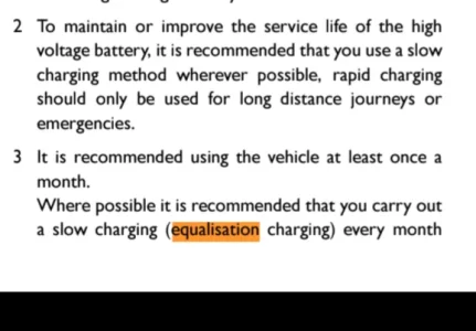

I have not seen a post by anyone stating they have seen the 'Please Slow-charge the Vehicle's message.
The third extract requires you to do a regular slow equalisation charge.

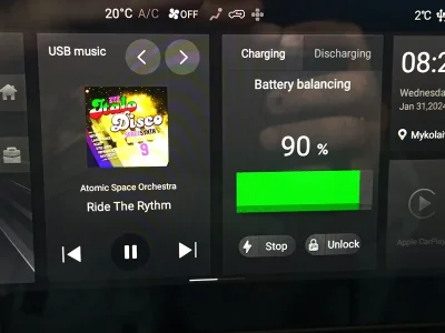

To continue the above, I believe my MG4 Trophy with its NMC battery equalises the battery cells after completing its charge to the set level.
Whilst it is doing the equalisation the info screen shows that it is doing 'Balancing', which can be considered the same activity. See image below (not mine):
