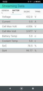

456 volts.I need some resources. Can anyone please send me
- video of the charging light pulsing
- video of the charging light solid
- photo of the dash showing 449 volts
- photo of the dash showing 455 volts
Superb range!456 volts.

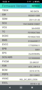

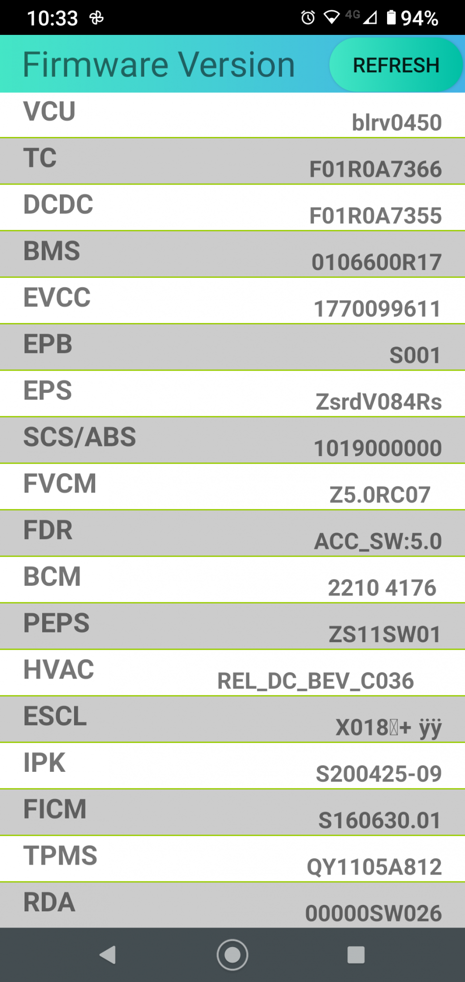

My charger is a Wallbox Pulsar Plus. I got my son in law to try his e Golf on my charger in case it was a charger issue but his car charged every time we did a delayed charge on his car.What smart charger do you have?
Ask your dealer to ensure that they have updated the EVCC module to allow for 10 hour delay to charge starting. The software in my EVCC that allows this is software code 1770124111.
