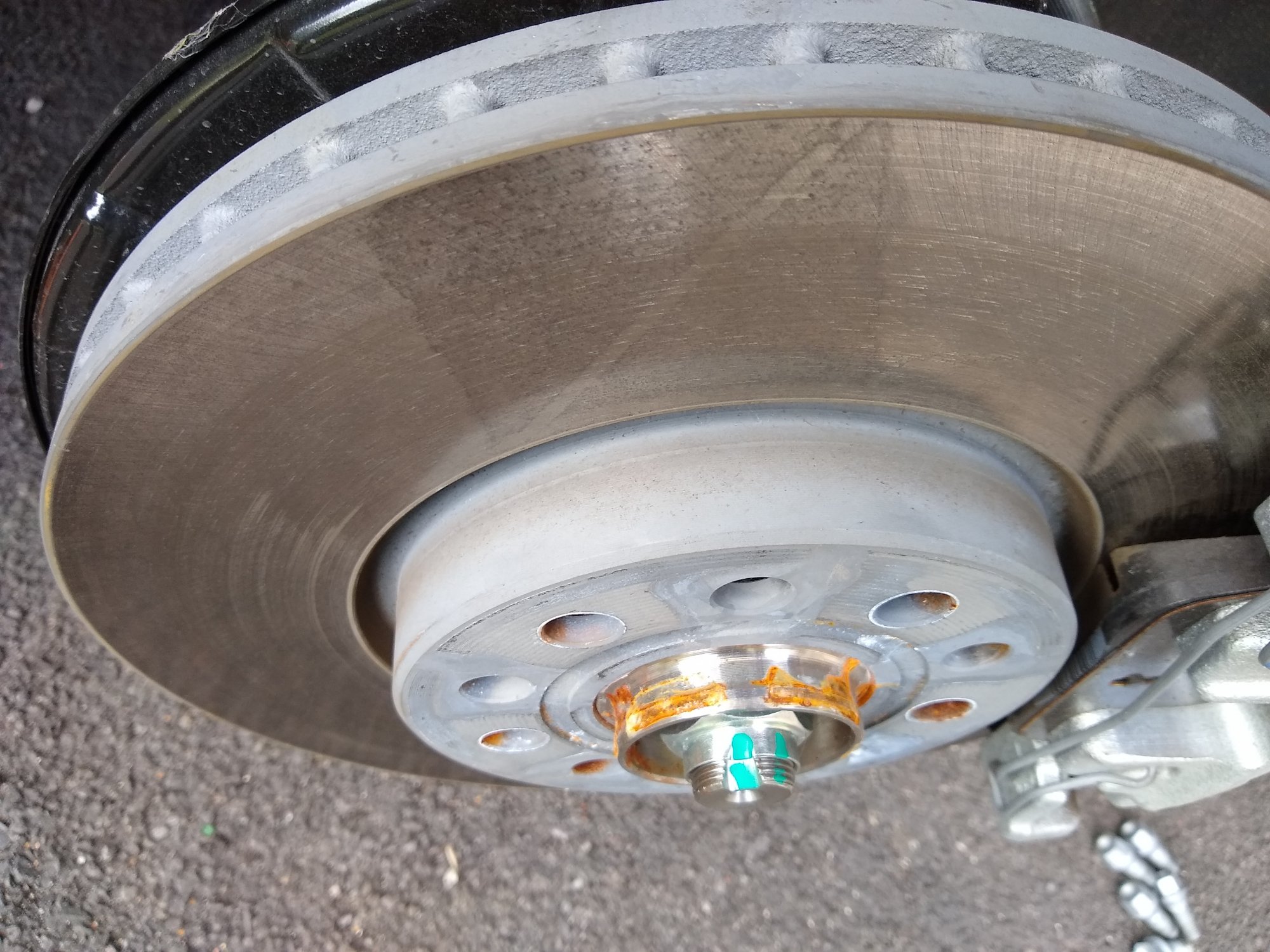

The front hub is different to the rear insofar as the faying surface is coated:
The corrosion here is concentrated around the (uncoated) collar plus there are traces in the bolt holes and these aren't natural cavities.

@Alb Absolutely bang on, great image of the evidence that causes the problem !.
The rust around that mild steel hub collar, displays exactly where the issue is triggered.
But you already know this of course, and know how to deal with it my friend :giggle: .
Not a "One Off" - It will be on every car OBTW.
It will continue to get worse if not teated and the rears will be more likely to be affected more.
Not just on MG's it has to be clearly said, I have seen this condition on many VAG vehicles.
