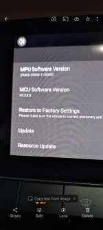

How do I do that?
From another post
This one would be R29 (Last digits of the System Version)
My car is currently R33.
This is what mine says.
The image hasnt been added. (If you indeed tried to add one)
Ah so yeah you are now on R33 which is the same as mine, ive read there is a R46 but that fixes some things and takes others away.
Seemingly MG Dealers wont upgrade upon request, only if you have an issue that is meant to be fixed on later firmware and they have to get approval from MG too, my dealer wont do any work unless approved (then paid for) by MG.
I had a ID3 before this and VW were happy to update firmware upon request.
just remember the R number in that screen is only the infotainment software - so the display, camera, bluetooth etc. Anything to do with LKA, charging, regen etc is different software you cannot easily find the versions of
