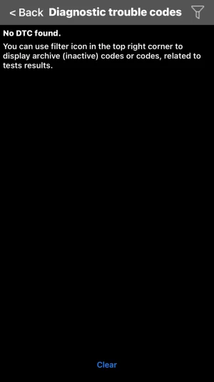

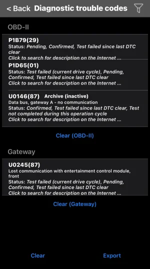

Just checked my error log via OBD and I actually had some errors. So I cleared them, let the car sit for a couple hours and took it for a drive and also messed with some settings in the AC menu but nothing showed up. I really believe it’s an issue with the software - therefore the hardware works fine the software just isn’t activating the heater. The MG infotainment software really only is an android phone running an app launcher and every feature is its own app. The factory reset just resets the app launcher but not the apps then selves. I think a complete redeployment of the software should fix it.

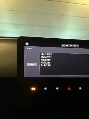

Actually the MG is displaying something within the DTC in Engineering Mode - But these are not normal DTC errors as they are hexa decimal - anyone has an idea what these are? Maybe they are related to the Android system?

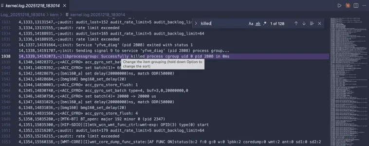

This is almost 130 times in the logs: yfve_diag seems to stand for Yanfeng Visteon Electronics wich seems to be the hardware supplier for the infotainment. Status 1 means its a crash - so there is for sure something wrong.

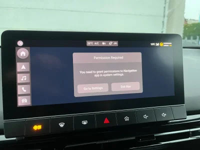

This seems to be an issue with SELinux policy and would also explain another issue that I have (navigation isn't working because its demanding some permission). I tried to reset it and everything but nothing did work. I also have accepted the privacy notice (which usually is the issue for this error). The Android logs also show that the GPS is working and that the navigation is activated.

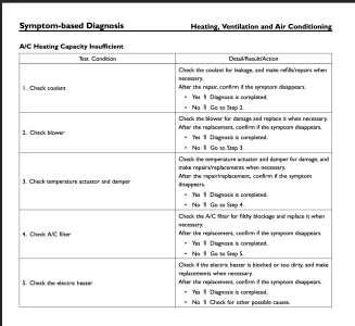

I checked the Symptom-based Diagnosis Manual (the official one) and they haven't done any of these things and instead want to waste hours on checking cables. So I guess I will have to bite the bullet and pay the bill - But I will have a conversation with the manager for shure about the prices in relation to the work done. Safe to say: They will never see me again there!
