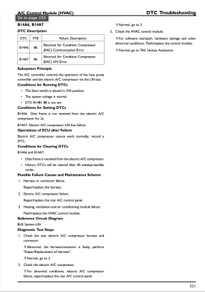

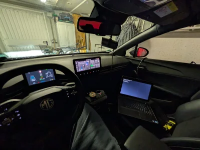

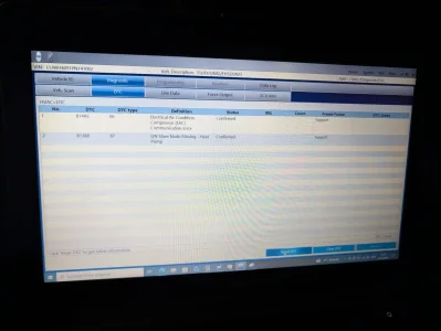

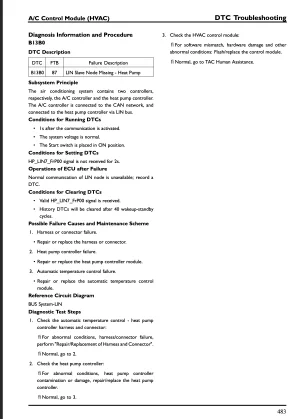

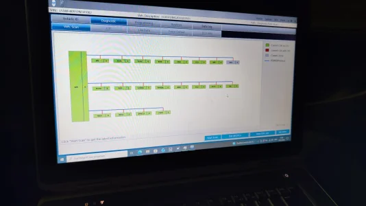

Ok, have some Updates:
VDS displays 0 kpa pressure on the ac line and I also have error Codes from the HVAC. So either the system is drained and the compressor isn't answering because it says stop! Or there is indeed a broken wire.
I will check the pressure using a screw driver to press on the vent and see if there is something on the line.

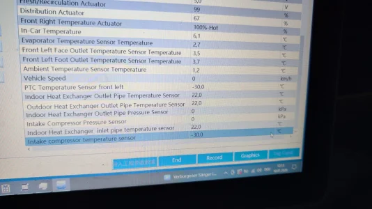

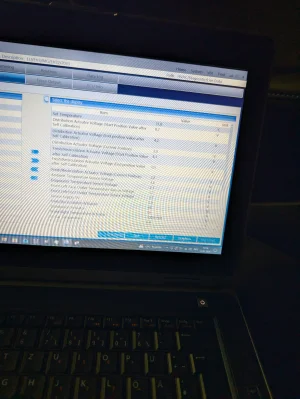

Good work!
I also see some very odd values in the 2026-01-10 at 12.13.23.webp-image. Like an actuator at 100% (hot) and two values at -30C. But at least we now know it has a ptc !
Good work!
I think that could be default values that get displayed when there is no response (maybe a fried compressor that also could be responsible for the leak). That also would explain the errors.
I see. So sensors/actuators do have power.
Would be interesting to know what the set T for PTC is if the system is working. And if we could change that value.
Yeah. 100% hot btw seems to be a heat pump valve (as I set the temperature to 31 deg it's says hot and open 100%- so full throttle).
Visited another dealer today (where I bought the car) and what the other shop was not able to figure out in 6 weeks only took them 3-4 hours.
Issue seems to be the compressor. They:
  • read the dtc error cache and found the compressor error
  • updated the hvac + infotainment
  • did a full ac service (check pressure + full replacement and refill of the ac gas)
  • and maybe even some other minor stuff which they haven't told me
No waiting for 4 weeks for the next appointment and other bs - they opened a ticket with MG and if everything goes to plan my ac is back up soon. I also got the chance to checkout the new MGS5 (great car) and they also told me that we get the facelift MG4 with the interior of the MGS5 very likely in February.
