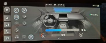

Does anyone have any information on whether the heating fault has been resolved by MG? I purchased an MG4 Luxury and the heater is not working either. It doesn't matter if I set the heater to AUTO or ECO or 30°C. It only blows icy air. Even on AC the windshield doesn't fog up, as if the A/C isn't working either. I have the heating set according to the photo. Thank you for any information.
