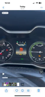

Thank you. So, I charged the 12v battery with the negative terminal decoupled. The granny charger was not plugged in at the charging port. After reconnecting the negative terminal, I checked the instrument cluster. The 12v battery is now showing 14+v on the dash. I reconnected the granny charger, locked the car and turned the power on. Still connected but not charging. The Hv battery is still reading ‘- -‘. I’ve attached a picture. The main battery indicator is a single line flashing. I don’t recall hearing a distinctive sound of the contactor but the sounds are much like I remember them.

I don't know if the ZS is the same, but on the MG4, if you go into charging on the infotainment screen there is a start charging button.
