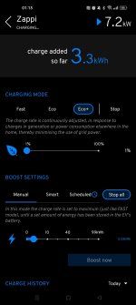

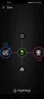

Update for these that helped and others like me that struggle a bit...
So stayed up till I figure it out and it worked.
Tried like someone said charging the solar storage and charging the car and it worked sending 4kW to storage and 7kW to the car. Then tried disabling storage charging and on eco+ it tried sending power from storage and grid to make 7kW in total draining my storage at home and then moved the eco slider all the way to 1% and it stopped draining the storage at home and used only grid to charge the car.
Hopefully this will help someone. Maybe different install will behave differently but worth trying. Picture of my electric box is a bit earlier in this post.
Thanks all the guys that send their ideas.
