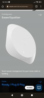

I think the inbuilt load management is for balancing the load for extra connected evse's and you need the accessory in the photo to get household dynamic load balancing/management
