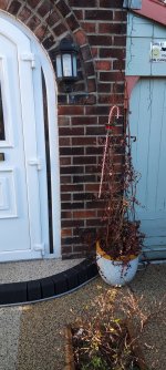

Was you looking to site it, on that pillar of brick work between the front door and the garage ?.I did but it was just a little too big for the wall where I want it installing
The door to the right of the brickwork is to a full length lean to and the CU is around 4.5m along that wall as shown in the photo with the lean to door open. Excuse the clutter ?Was you looking to site it, on that pillar of brick work between the front door and the garage ?.
If so, it will fit there with no problem I think.
Where is your CU ( fuse box / meter ) located, in relation to that column of brick work @jpk ?.
It will fit if you move the plant?I did but it was just a little too big for the wall where I want it installing
