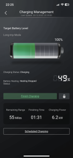

We have the easy charger 7kw and yes on the app it also says 6.1kw charging rate I did wonder why it wasn't 7kw now I see that seems to be the norm. we have the se Sr
About 6.2 is the most I’ve seen on my 7KW podpoint as well.
Not that I check every charge, every time.
