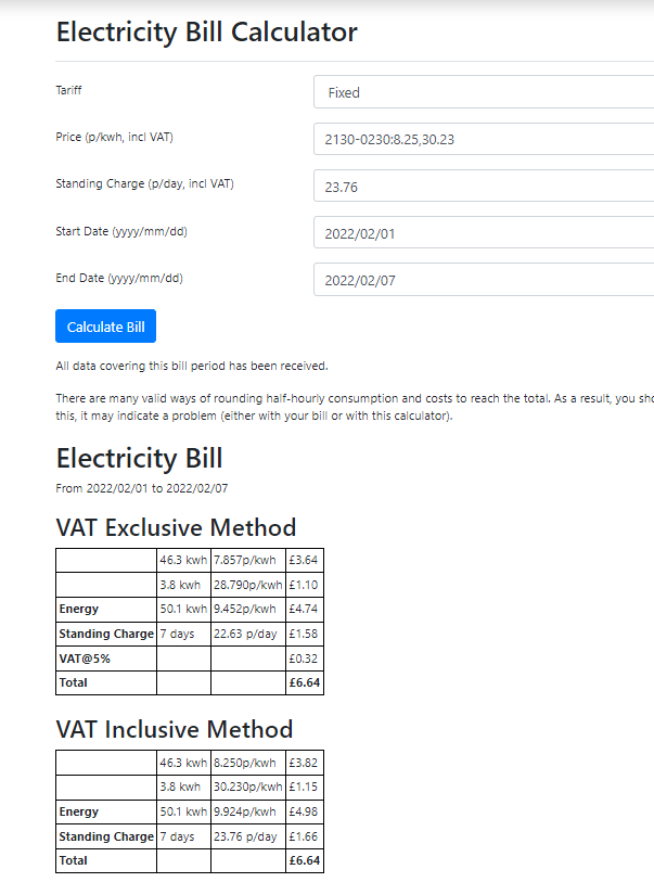

For the benefit of everyone, adding a screenshot of what I've been charged for 1 week of electricity which includes normal day to day use + one EV charge from 65% - 100% with my current setup in the last 1 week :
