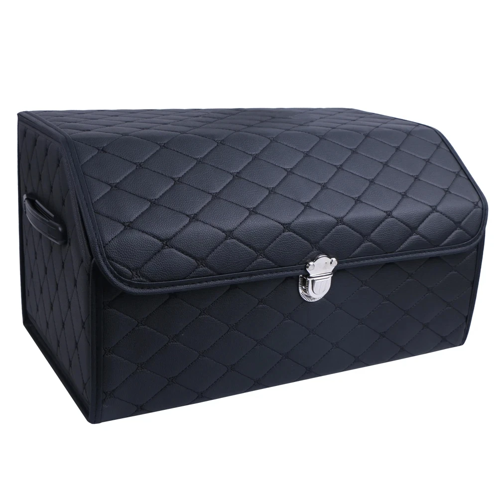

Aaand.. the other route:
The charger box I'd probably never use takes up this space 20 d x 36 w x 30 h cm
7.87" d x 14.17" w x 11.80" h
And the compact box is:
7.06" D x 20.69"W x 12.25"H
Hmm now that i see it - this box is wider... Less deep and also same height.
From 36 to 52.5... (14" to 20")
Yep, i dont feel these measurements are right.
And then put one of these on top with velcro to secure - same wide. A little bit deeper but can fit
