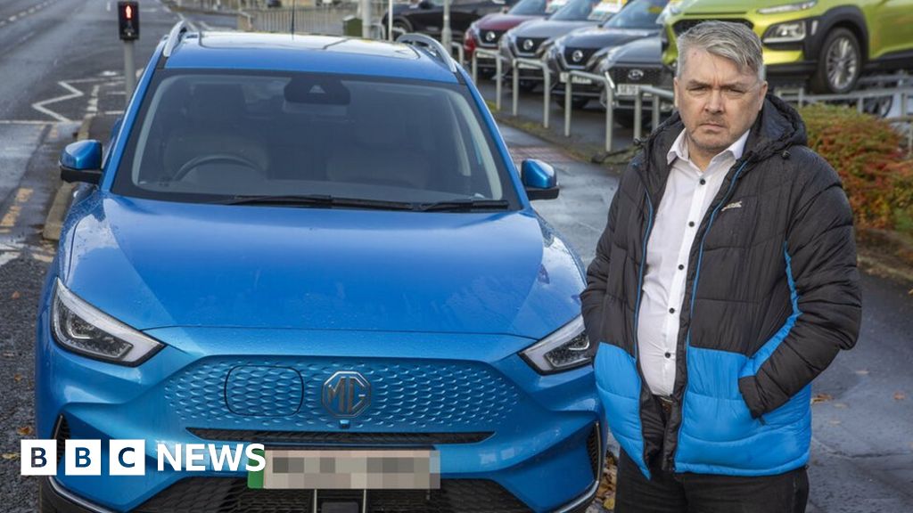

Interesting/worrying story from Scotland - ZS with no brakes.

After reading the story kindly posted by @N2STY.
It appears that Brian had only had his EV for a short while, was this Brians first EV ?.
Was it possible that the adaptive cruise control / pro pilot had been engaged inadvertently ???.
This would account for the car maintaining its steady speed, but does not answer the question why it did not disengage when the foot brake was pressed ?.
Had the floor carpet rode up over pedals ?.
What did the police officer simply do, to turn off the car when they brought it to a total stop ✋??.
It’s strange one alright !.
I am sure many other owners will be eagerly awaiting both the insurance and MG’s evaluation / investigation into the cause of this incident.
Regardless if it is “man or machine” at fault here, it really is not something anybody would willingly want to be subjected to or happen again on another vehicle.
I am sure other motoring authorities like the DOT and the MAA will be monitoring the progress on this story.
It really goes without saying that this requires very urgent attention now, in order to establish the true cause of this serious incident.
I expect that both the MG CS switch board and the MG dealers switchboards, will be bombarded with calls over the next few days. Owners wanting some concrete reassurances that their cars are still safe to be used !.
Of course the anti EV lobbyists will jump right onto top of this story, but it fairness it would be the same if it was an ICE car.

Hello. My name is Brian Morrison and i can verify that everything in my facebook post is 100% True.
I am still shaken up. How dare most of you even consider i am lying after what i went through driving home from Kilsyth through Kirkintilloch and heading towards Bishopbriggs where i live.
It does not matter to me what people think, but please think about peoples mental health who could still be struggling after such an incident.
I was coming here to actually post all about it, to see if anyone had similar issues .... and shocked to see so much negativity
