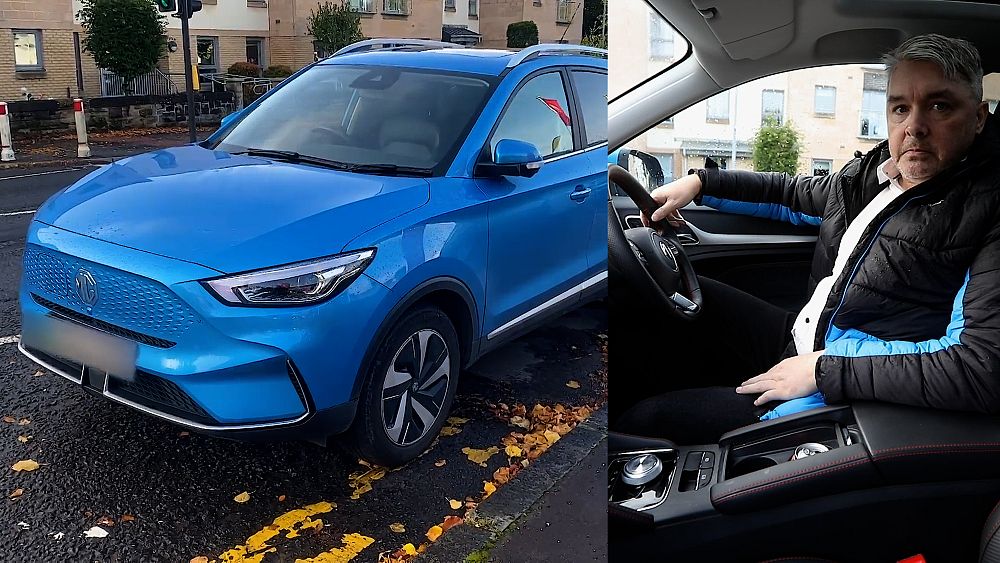

All I know is that this afternoon I drove past a secondary school in an identical car to the one that was on the news yesterday and a bunch of lads thought it was hilarious to point me out, maybe they were just impressed that I had the car under control?!
According to the news report he has mobility issues, so maybe could not press the brakes hard enough. Fwiw
Is it me, or is the picture of @MGZS nothing like the picture on the news?! I think that post might be fake, particularly given there have been no further posts since.
I'm sure we'd all love to hear from the real driver to try to understand the full circumstances of what happened.

As I've mentioned earlier in this thread, I used to know him. The picture here is still him, but not a recent picture. Why he wouldn't use his Facebook picture or something more recent is beyond me.

You're right. The avatar for @MGZS is not the same guy who features in the news articles and on his Facebook profile. So @MGZS is probably fake or maybe the real guy using another individuals picture. This gets more intriguing by the hour.
It is the same guy, but the picture here is about 15 years old!
Saw your post, which was very interesting. I still wonder if the thread post is fake though. You've posted 45 times and I've posted 28, yet neither of us feel the need to create an avatar. Yet this user comes on and creates one straight away with his first post?
Curiouser and curiouser!
I would not read too much into that little factoid.
Edit: However, I'll admit that the 15 years old image (if true) is weird. It does suggest wanting to garner sympathy.
