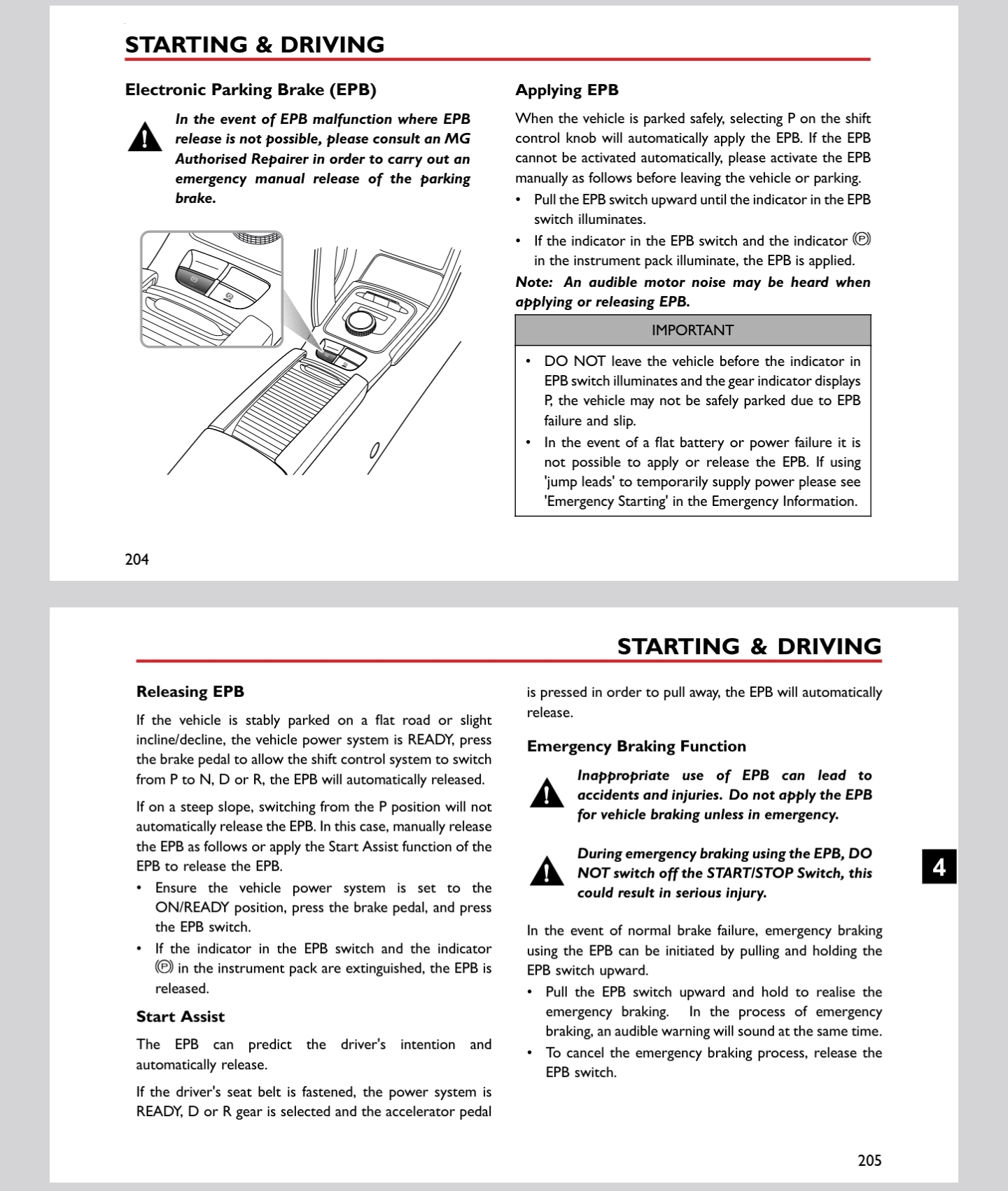

Hi. Is the EPB button the central one with R N D which you press to engage handbrake? Tia
The EPB is a separate switch on the centre console, not the one in the centre of the drive selector. You lift and hold the switch to activate everything, and it makes a bit of a racket, so you know it's on.
Where abouts is it on the centre consol?
Ta. For some reason I was thinking of the E meaning 'Emergency' and not 'Electronic', albeit reading it, it can be be used for emergency braking. Interesting to note the comment about not switching off the START/STOP switch, whilst emergency braking, as it may risk serious injury.
I think that's probably the same warning that's been on most cars for decades, not to turn off the ignotion when you're driving
