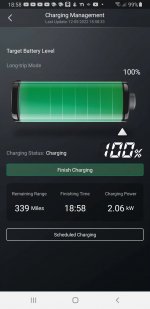

Thank you very much for sharing this information ... I was already thinking that something wrong about this subject ... Because if we are supposed to not to make a full charge then how we couldn get the benefit of buying a Long Range car ... I did it once and charged my batteries %100 and reached a 340 miles range with a average consumption of 4.5 miles per kw
