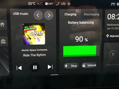

1 All AC is slow charging, all DC is fast charging. 2 Batteries are made by another manufacturer, mainly CATL and they also install BMS, MG only installs it in the car. 3 When I had MG MK1 balancing only occurred at 100% charge, this is a current of 350-400 mA power about 0.3 kW. Now I have MK2 and balancing occurs at 80% and at 90%, current 400 mA per phase and power 0.4 kW and time from 4 to 5 minutes. At 100% the same parameters only the time is longer. 4 For information, when charging 16A, the real current will only be 14.7A, 10A - 9.2A, 8A - 7.2A. The measurements were made on several cars and were the same everywhere.

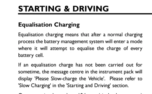

@Data, you have stated that you have been told that to achieve a proper balance you need to have seen the low battery warning so that the BMS can control the charging and then take to 100%. You quote 20% as the trigger for the warning.
My Trophy has been down to below 10% in the past but I have never seen the warning in the 2 years I have owned the car. (Note I have never seen the battery level colour changes either.) Is this warning that which is referred to in the manual extract below?
The manual implies that if the BMS has not triggered the warning then equalisation must have occurred within the allowed time limit. I normally keep my car's battery between 30% and 80% allowing it to 'balance' every charging instance. I now don't do long distances so charging to 100% can be up to 6 months apart. I have not done a <10% to 100% charge in over a year but my GOM has been as accurate as I would expect it.

I would have thought that if my BMS is wildly out of calibration then it would be clearly indicating it as set out in my MG4 manual extract above. Otherwise what is the purpose of that low battery warning requiring equalisation?

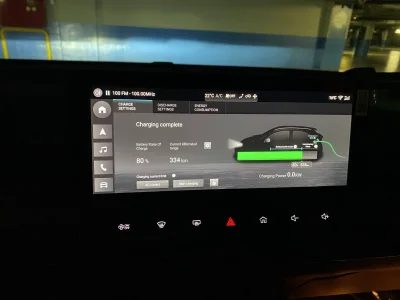

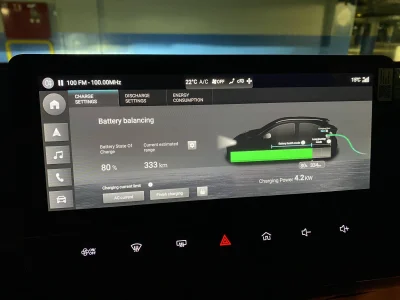

2 more images:

@siteguru, the images I posted are not from my car but from posts to the MG4 forum.

And Martin's images show that he has a target charge level setting ... as he has an MG4 then his car has an NMC battery pack, not LFP. :)
