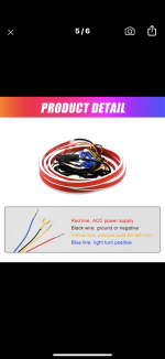

Hello, I have fitted a light strip to my x power which looks great. I want to change it for the one with progressive indicators built in but I am unsure how to access the front bumper indicator wires? And also which is the correct colour wire to clamp onto? Has anyone done this please? Any help appreciated thanks.

There’s a wiring diagram online that might help you.
You also might get the other info you need in the service manual, which is also online.

What is the strip powered by? What connections have you used?
Get yourself a wire probe.
Open bonnet.
Find the wires leading to the Headlight unit.
Put on sidelights.
Probe wires til you find the live.
Splice in, and don't forget to earth.
You will void the warranty on your entire lighting system.
Have fun.
