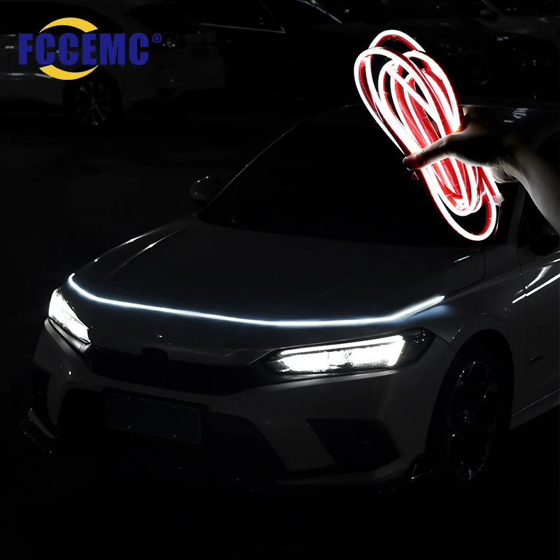

Hello, I have fitted a light strip to my x power which looks great. I want to change it for the one with progressive indicators built in but I am unsure how to access the front bumper indicator wires? And also which is the correct colour wire to clamp onto? Has anyone done this please? Any help appreciated thanks.
Looking to fit this to my mg4 trophy,
Not worried about the indicators just as you have as pic.
What is this item called and where from.
Get yourself a wire probe.
Open bonnet.
Find the wires leading to the Headlight unit.
Put on sidelights.
Probe wires til you find the live.
Splice in, and don't forget to earth.

the F89 fuse is a +acc, this allows you to turn on the LED only when the car starts and turn it off when stopping without adding a switch. If you do not understand this, do not attempt to do it yourself, you could seriously damage your car.
Here is the LED installed and in operation

Just google “auto electrician near me” then its done properly ?. Hopefully this page now shows why I didnt want any blame so stayed out of it. Updated post further down. Took this one off. Trying to work out a multi colour one with indicators in it. Ali express.
Ali express is where all the nice mg4 bits are. Then google “auto electrician near me” & let a professional fit it ?
What is the strip powered by? What connections have you used?
I took this one off. The live was fuse tapped & the earth is clamped under a wing bolt. Trouble is your fuse box lid wont seal shut (theyre weather proof). Ive since learned the Red can be clamped/spliced to the DRL instead. I have a new one with indicators built in & different colours too. Im removing plastic under tray & under bonnet cover to see if I can access the indicator/ DRL wires. IF I work it out it would be nice to post a video for other members but I dont think we can do that on here?. All the light strips are on Ali express.
