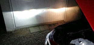

I’ve installed night eyes the other day, what a difference.
Could you share the exact model to buy and a rough price please. I’ve also picked up that care is needed when changing the headlight bulbs due to breaking a fitting?
thanks - Rob
