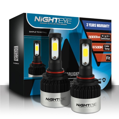

Hi Gary,
On this thread, Jeps (Member) quoted he managed to get some Novosight LED Bulbs that are 1500 lumens and even brighter.
But you won't be disappointed with the Nighteye, which are from the same Chinese Manufacturer, just a different brand name.
As I previously posted on here, the Nighteye Brand Name is currently being re-branded as Novosight, but there are various levels of the bulbs, some offering higher brightness output, but these are mainly for "Off Roading Use", rally cars etc.
I have not had any problems of other road users flashing me to say my headights are too bright or dazzling an oncoming driver, but not sure if 1500 Lumens was too bright on the normal road.
Technically it should be mentioned that you are suppose to have "Self Levelling Headlamps" to be able to fit LED Bulbs, which of course the ZS EV doesn't have these at the moment, but you can manually adjust the headlamp levelling at anytime if you are carrying extra weight in the vehicle with the control to the bottom right of the driver on the dash.
But under normal circumstance, they haven't caused a problem for me.
Andy
They are very good..?Noticed the price has gone down to £17.69 so have ordered a set.

Use these NIGHTEYE 72W HB3 9005 COB LED Headlight Kit Lamp Bulbs 72W 9000LM 6500K White UK | eBayReally basic question I am struggling with here. It seems that the MG uses one bulb for both high beam and low beam, while other cars have a separate low beam bulb and a separate high beam bulb. Does that mean we need to get a dual beam LED bulb (which I cannot seem to find in an HB3 version)? All the above LED bulbs that you mention only seem to be one type (high or low) and not dual beam. How does that work with the MG? Do you have low and high beam capability? Sorry if I'm missing something obvious.
The MG5 has a single beam projector headlight - there's a shutter in the unit activated by the dip which cuts off part of the beam. You definitely need a HB3 / 9005. I went for the Koyoso ones linked somewhere on here; excellent and worth the price.Really basic question I am struggling with here. It seems that the MG uses one bulb for both high beam and low beam, while other cars have a separate low beam bulb and a separate high beam bulb. Does that mean we need to get a dual beam LED bulb (which I cannot seem to find in an HB3 version)? All the above LED bulbs that you mention only seem to be one type (high or low) and not dual beam. How does that work with the MG? Do you have low and high beam capability? Sorry if I'm missing something obvious.
