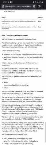

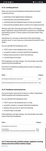

You're kinda sorta right...
The MOT Inspection Manual, section 4.1.4 says putting the LEDs (or HIDs) into a non approved housing would make it a failure.
But section 4.1.5 only says that levelling systems should be checked if fitted, and 4.1.6 only applies to cleaning systems fitted after late 2009. Neither are compulsory.
Is it an MOT failure? Yes. Is it likely to be checked? ?‍♂️.
@macd2401 Thanks for the posting of MOT Inspection Manual para 4.1.4. However, reading down your attachment it says the following:
"Existing halogen headlamp units first used on or after 1 April 1986 must not be converted to be used with high intensity discharge (HID) or light emiting diode (LED) bulbs. If such a conversion has been done, you must fail the headlamp for light source and lamp not compatible.
This does not refer to complete replacement headlamp units which may be constructed with HID or LED light sources"
Therefor since the MG ZS is not sold with HID or LED units in any variant in the range there is not complete replacement available to be fitted and any ZS EV on the road with LED bulb fitted would be an automatic MOT failure so would be illegal if inspected at any time for example a police stop.
Therefore since the MG ZS is not sold with HID or LED units in any variant in the range there is not complete replacement available to be fitted and any ZS EV on the road with LED bulb fitted would be an automatic MOT failure so would be illegal if inspected at any time for example a police stop.
Never said it wouldn't. And in fact I did state that in my post. My issue was where you said that LEDs need washers and self levelling equipment to be legal. As I said in my post, they're not required at all, but if they're fitted, they must work. And that would apply to new vehicles, as well as aftermarket headlamp assemblies as they become available.
Just being pedantic but is changing the bulbs the same as ...
Existing halogen headlamp units .......... must not be converted to be used with .....
Who's converting the headlamp unit ?
