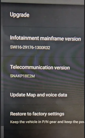

I have updated my Marvel in the last five months here in Germany by an MG dealer in my city, it got the R32 version, it is the last upgrade.

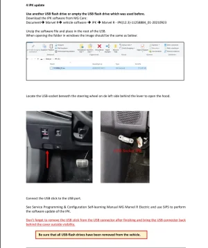

I have all MG Marvel R maintenance documents. (see the attachments for example).
But you need a company (or a dealer) account to download by the USB updating METHOD .
For SIPS (SAIC program system) updating METHOD you need a high end scan tool (i have the Autel MaxiPRO) that support the last Softwares from SAIC-MG motor ( here you do not need a special account).
